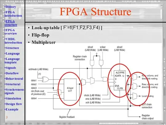

When you look at the structure of an FGPA - it appears to only have slightly more complexity than a 4-bit adder.

    You are wrong @hawkeye. The basic cell of an FPGA usually has one or two flip-flops and that marks a huge difference against a "simple four bit adder" which is a purely combinational circuit. Then you have the routing, which gives you the possibility of making complex logic. A brain is not only the neurons, it is also the interconnections. An FPGA is formed of LUTs, FFs, and routing (and nowadays huge complex hard IPs, like complex processors, transceivers, and Mbits of RAM). – Claudio Avi Chami Jan 06 '17 at 05:29

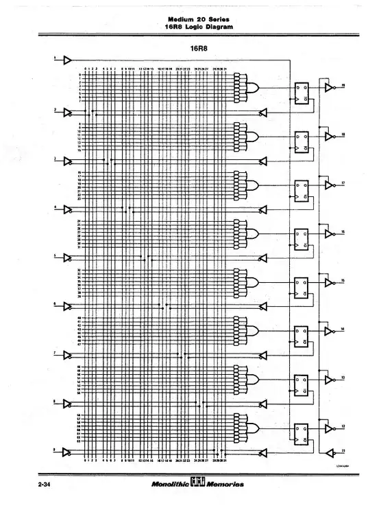

The schematic for an entire chip, unprogrammed, looked like this:

Note the two lines starting "CLK" ... they are names for the pins in order, numbered from 1 to 20. These correspond to the schematic above (which doesn't show pins 10 = GND or 20 = VCC, which are predetermined). Comparing this with the schematic you'll see that CLK and /OC are also predetermined, and all the other input pins are on the left, outputs (registered) on the right.
Also note that this design is for a 16R6 but it'll fit a 16R8 because pins 12 and 19 (which are unregistered in the 16R6) are unused - i.e. NC - in this design.
