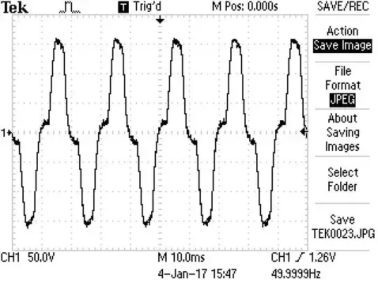

Here is the oscilloscope output when the probe's tip is connected to one of the terminals of the power supply:

  • leakage cap is stray interwinding capacitance. The 10M probe sees 320Vpp out of 750Vpp ac input . That is less than half the 750Vpp of 230Vac(rms). So you need to use a 1M probe or add a resistor for a 2nd test to verify the impedance of this 320Vpp signal such as 50 Ohms. you should be able to generate a couple hundred volts on your *ungrounded scope probe* with just your ungrounded finger because your body is an antenna to stray line E fields which are high impedance. report back your results. Then try 50 Ohms across probe. Then try 1mH. For your education. – Tony Stewart EE75 Jan 05 '17 at 02:28
