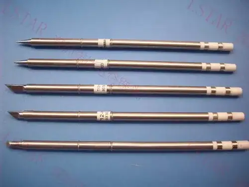

These are T12/T15 tips:
They contain their own ceramic heating element, and slide into a female receptacle in the soldering iron handle. They're designed to be used with a completely different style of iron than the FX-888D. They are about as compatible as oil with water. Unfortunately, if you want to use some of those more interesting SMD tips, you'll need to buy one of the irons that uses them (or a cheaper knock off, which can use those tips as well).
