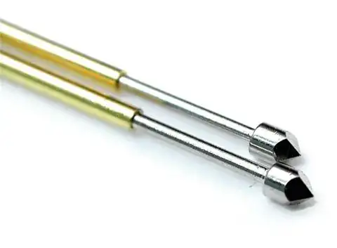

It might be easier to bring out the programming pins to some pads then use pogopins to attach your programmer.

  • what the heck are pogopins... are you talking about a 2x3 ISP header (see my answer below) – vicatcu May 28 '10 at 18:11
    Pogo pins are metal rods with spring-loaded tips. They're often used in test fixtures when you need to make a temporary connection to a circuit. – pingswept May 28 '10 at 18:16
  • Picture of pogo pins: http://www.flickr.com/photos/pingswept/2280832792/ – pingswept May 28 '10 at 18:17

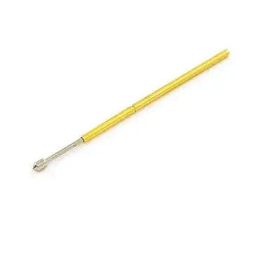

With In Circuit Programming you program the device after PCB assembly, so with the controller mounted on the PCB. On the bottom of the PCB I have test pads which bring the for programming required signals outside. Typically that's JTAG, but it could also be a serial port. Have the engineering department build a test jig with spring-loaded test pins matching the test pads.
You'll need test pins to supply power too. I usually add a few extra test pins for for instance measuring certain parameters, or a communication channel where the microcontroller can identify itself (think software version). You can't have too many test points. You don't need the space-hungry connector (which also costs money), and you can place the test pads wherever you please. There's always place for a 2mm pad.
