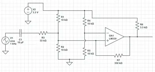

I'm trying to simulate the circuit posted here, which looks like this:
I'm running a transient analysis and have the following settings:
I expected to get the output as a square wave, but I'm getting this instead:
Does anyone know why I might be getting a zigzag wave rather than a square wave?

  • @KenShirriff I'm using CircuitLab. I just made some changes to [this circuit](http://electronics.stackexchange.com/plugins/schematics?image=http%3a%2f%2fi.stack.imgur.com%2fzPIq2.png) (I can't save mine without a subscription!). – Kar Dec 31 '16 at 05:36

Here's the circuit I tried:
Since the input signal is a 1kHz sine, you need to put much smaller numbers than the signal frequency as time-step. And also, since this is a comparator, amplitude of the input sine wave is quite important.
