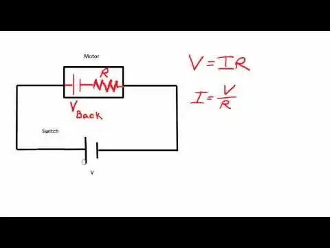

motor circuit
where the EMF appears as a voltage source in series with the motor resistance. While this may be a good way to explain how the current will behave, it doesn't seem to explain what actually goes on inside the motor. Surely, the EMF doesn't appear "before" the motor, but rather inside it. Should it then somehow be seen as being superimposed on the resistor? Where, in the first figure, would the EMF appear? Does it change the voltage across the brushes? Where does the "extra" voltage drop happen?

The back EMF is generated in the wire that makes up the coils of the motor. When a wire is swept sideways thru a magnetic field, a voltage is generated along the length of the wire. Spin the motor with just a voltmeter connected, and you will see it make a voltage.
So yes, the resistance and the back EMF are actually distributed along the wire in the coil. There are lots (infinity, actually) of little resistances in series that each get a little voltage in series with them when the motor turns.
Viewed electrically from the outside, this can't be distinguished from a lumped resistance in series with a lumped voltage source. Since this is simpler to draw, think about, and analyze, that's how motors are usually shown.

  • I think it's the part with the infinitely many little resistances I have trouble grasping. The EMF causes the current through these resistors to decrease, right? Decreased current implies decreased voltage. So where does the rest of the voltage go? – Daniel Nilsson Dec 30 '16 at 14:49
    @Dan: No, the back EMF doesn't inherently cause a current thru the resistor. Think of the many distributed resistors and voltage sources as being in series, not in parallel with each other. The voltage is created when the motor spins, regardless of how it was made to spin. If you drive the shaft externally, then you can see that voltage directly. If you spin the motor by applying external voltage, the little voltage sources appose the applied voltage. This means the motor "sees" less applied voltage the faster it spins. – Olin Lathrop Dec 30 '16 at 14:57
  • @Olin Ah, so it would be more accurate (although still a simplification ofcourse) to see it as an infinite number of infinitesimal resistances, and between each there is an infinitesimal voltage source? – Daniel Nilsson Dec 30 '16 at 15:01
    @Dan: Yes - - - – Olin Lathrop Dec 30 '16 at 15:05

You can simplify things by removing the battery from that diagram, and turning the motor by hand, as a generator.
As the armature turns, the wires cut through the magnetic field, and a voltage is generated in them.
This voltage is the same whether the armature is turned as a generator, or as a motor. When it's turned as a motor, this voltage is called the 'back EMF'.

Think of it like a generator; you spin the rotor and an output voltage is produced. This voltage is in series with the rotor coil. It makes no difference if instead of manually spinning the motor you apply dc to turn it.
