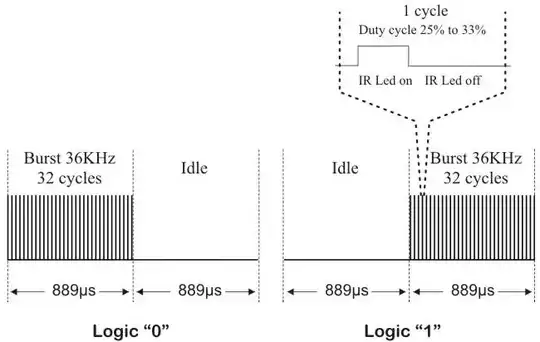

All variants specified a fixed carrier frequency, typically somewhere between 33 and 40 kHz or 50 to 60 kHz. The most commonly used protocol is the NEC protocol, which specifies a carrier frequency of 38 kHz.
  • The NEC protocol is used by the vast majority of Japanese-manufactured consumer electronics.
  • The Philips RC-5 and RC-6 protocols both specify a carrier frequency of 36 kHz. However, the early RC-5 encoding chips divided the master frequency of the 4-bit microcontroller by 12. This required a ceramic resonator of 432 kHz to achieve a 36 kHz carrier, which was not widely available. Many companies therefore used a 455 kHz ceramic resonator, which is commonplace due to that frequency being used in the intermediate frequency stages of AM broadcasting radios, resulting in a carrier frequency of 37.92 kHz (essentially 38 kHz). Even documentation for Philips' own controller chips recommended an easier-to-obtain 429 kHz ceramic resonator, yielding a carrier frequency of 35.75 kHz.

Mechanical ultrasonic audio became electrical ultrasonic audio became Infrared ultrasonic modulation. All the while, the processing electronics could evolve without disturbing the other parties and could remain compatible with their immediate legacy counterparts.
Additionally, operating at MHz scale modulations would severely curtain range and increase cost as it would require shorter accumulation times in the receiver, which would make the receiver more vulnerable to noise (lower signal per pulse, ergo lower SNR)
