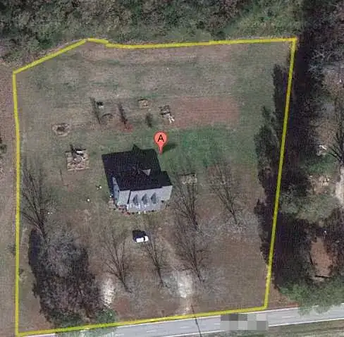

I am getting back in to EE after some time so please excuse my ignorance. I am looking for a way to detect pinpoint location outdoors to navigate a robot for a project with my sons.
Is there a low cost way to triangulate or use GPS? I am looking for down to the inch precision. Also I do not care if I need to place some transmitters in different locations to give the device a reference.
This is for a robotic lawnmower. I have a 2 acre yard and my house is near the middle with several trees as obstacles.
My 2 acre yard
Two of my three boys (14yrs, 11yrs, 5rys old) brought up the idea so the real goal of this project is to spend time with them and pique their interest in EE & CE.
With that said cost is a factor but I do not care if we work on it for the next 2 years and spend a little along and along.

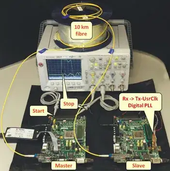

To measure the propagation delay between two points accurately requires primarily two things: 1) A straight line signal path since reflections will create distortions. 2) Some electronics on both ends using synchronized clocks and the ability to measure time intervals to the precision required.
Synchronized clocks are relatively easy as the receiving station can derive it's clock from the signal being transmitted by the other station. This is standard synchronous data transmission with clock recovery.
Here is a paper Measuring propagation delay over a 1.25 Gbps bidirectional data link where they easily get this kind of accuracy over a 10 km long piece of fiber optics. They state: "It should be able to synchronize ~1000 nodes with subnanosecond accuracy over lengths of up to 10 km."
In this note a method is described to determine the time offset between two nodes. These nodes are connected via an 8B/10B coded 1.25 Gbps bidirectional serial point to point communication channel, as for example is used by 1000BASE-X (Gigabit Ethernet). The time offset is determined by measuring propagation delay using a marker signal. The signal is sent from a master to a slave node and back using serializer/deserializer (SerDes) functionality in (Virtex-5) FPGAs. The recovered clock at the slave node is used as the transmit clock of the slave so the complete system is synchronous. For a 1.25 Gbps serial communication channel the delay is known with a resolution of a single unit interval (i.e. 800 ps). This resolution can be further enhanced by measuring the phase relation between the transmit and receive clock of the master node. The technique has been demonstrated to work over a single 10 km fibre that is used at two wavelengths, to facilitate a bidirectional point to point connection between master and slave node.
also
A first test setup was built to verify the principle of measuring propagation delay between a transmitter and a receiver using a coded serial communication channel operated at 3.125 Gbps. The transmitter and receiver reside in FPGAs on two separate development boards. This first test setup showed that it is feasible to measure propagation delay over a 100 km fibre with a resolution of one unit interval (i.e. 320 ps at 3.125 Gbps).
EQUIPMENT USED:
The test setup consists of two ML507 Xilinx development boards [7]. A Virtex-5 FPGA is mounted on each board. One ML507 development board is designated as master node, the other as slave node. Master and slave are connected via small form factor pluggable (SFP) transceivers and 10 km of fibre, creating a bidirectional link. A single fibre is used that is operated at dual wavelength.
test setup
Now clearly this particular setup is overkill for most hobby robotics projects, but it could easily be reproduced at home since it uses off the shelf development boards and requires no special talents to get working. In the case of the robot the link would be radio rather than a fiber optic cable. Perhaps it could even be an IR link like a TV remote although I suspect that outside in bright sunshine that might be problematic. At night it could work great!

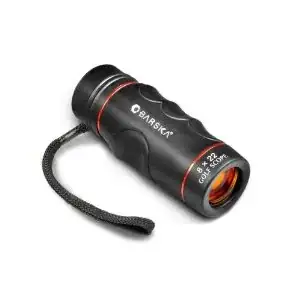

Now that you have modified the question to remove the requirement of one inch resolution and have told us you will have a Windows PC and a Microsoft Connect onboard, I think you could do very good location with just that hardware on the robot.
Have you seen some of the cheap Golf Scopes that people use to find the distance to the tee? enter image description here
The way they work is to measure the perceived height of the flag on the green (which is a fixed height) and show the distance to the tee. This is a simple right triangle where if you know the angle and the height of the far side you can compute the length of the base. This is exactly the kind of thing your sons will be learning in geometry and later in trigonometry.
Since your house seems to be visible from all parts of your lot, perhaps it would be easy to see 2 corners and compute distance?
