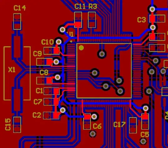

PCB layout: enter image description here
PCB layout with VDD hightlighted: enter image description here
PCB layout with GND highlighted: enter image description here

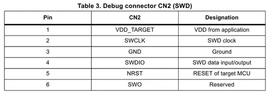

  • I have followed instructions in the STM32 Discovery Board's manual on how to use the Discovery Board to program an external STM32 MCU. To be more specific, I removed the 2 CN3 jumpers, and then I connected the boards as in this table: enter image description here

  • I usually have them a bit shorter. Can you post a picture of the layout from the swd connector to the pins of the MCU, highlighting those lines, to see if we can spot something weird? – davidrojas Dec 29 '16 at 12:31
  • Here are the pics, please take a look: This is [SWDIO](http://i63.tinypic.com/2h5k6dv.png). This is [SWCLK](http://i63.tinypic.com/316w307.png). And this is [NRST](http://i68.tinypic.com/2hdmuyw.png). – user3286500 Dec 29 '16 at 12:41
  • I am afraid I do not see anything strange, the connections look all right to me. – davidrojas Dec 29 '16 at 12:52
  • Well, I've also scratched my head for 2 days because of this and still couldn't find the answer. Thank you anyway for your comments. – user3286500 Dec 29 '16 at 12:55
  • I've had problems in using the Discovery boards st-link to program other boards. Most curiously, using a Nucleo board everything works. It may be related to the st-link versions of both boards. Just my experience. – Paulo Soares Dec 29 '16 at 12:57
    Did you notice that the ground pour under the chip is physically isolated, and not actually connected to any of the ground pins? The actual connections among the ground pins follow tortuous paths outside the chip, and some of them might actually be isolated. You need to adjust your clearances so that the ground pour does not have isolated islands, and this will help make sure that all of the ground pins of the chip are much closer to the same potential. – Dave Tweed Dec 29 '16 at 14:05
