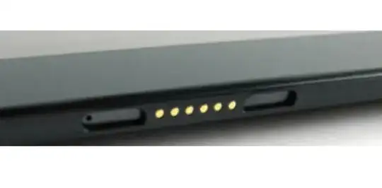

I've designed a circuit for a battery operated device which has a USB connector externally exposed for charging and data transfer. It is a non-standard, dockable USB connector with no shield connection available and the entire circuit is housed in a plastic casing with no chassis / protective earth possibility, something like the image below:

  • thank you for taking the time to answer.I'm providing further details here and will update the post subsequently. * "Since you haven't described what you are building": A battery operated, USB rechargable device with exposed dockable connector (pic updated).During testing,device will run on battery with no charger connected. * "The testing is also not described in your question": As per IEC61000-4-2, Level 4. * "do you mean positive with respect to earth ground":Of course it will be wrt the ESD gun's earth, problem is how to relate that with the floating battery ground of the device? – sbp9674 Dec 29 '16 at 04:31
