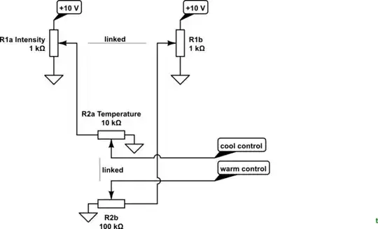

Figure 4. A very simple 0 - 10 V dimmer control.
How it works:
  • This control is designed to work with 0 - 10 V LED controllers.
  • It uses two 2-gang linear potentiometers (pots).
  • R1 controls the intensity. As the potentiometer is turned from minimum to maximum the wipers' voltage will increase from 0 to 10 V.
  • R2 controls the temperature. Note that the potentiometers' inputs and grounds are reversed. When turned all the way to the left the cool control will get the full value of the intensity setting while the warm control will be grounded and get zero volts. When turned all the way to the right the situation will be reversed.
  • With R2 in the centre position both lights will be at 50% intensity. This is intended design to maintain intensity across the range of the temperature control pot.
  • The 1 kΩ and 10 kΩ values are chosen so that R2 doesn't load R1 too much (as this would distort the desired linear adjustment.
