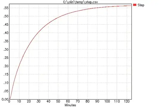

Here is a partial example using real world data. This from a embedded system in a real product that among other things has to control a couple dozen heaters to maintain various chemical reservoirs at specific temperatures. In this case, the customer chose to do PID control (it's what they felt comfortable with), but the system itself still exists and can be measured. Here is the raw data from driving one of the heaters with a step input. The loop iteration time was 500 ms, which is clearly a very short time considering the system is still visibly settling on this scale graph after 2 hours.
In this case you can see the heater was driven with a step of about .35 in size (the "Out" value). Putting a full 1.0 step in for a long time would have resulted in too high temperature. The initial offset can be removed and the result scaled to account for the small input step to infer the unit step response:

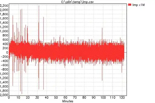

From this you'd think it would be just subtracting successive step response values to get the impulse response. That's correct in theory, but in practise you get mostly the measurement and quantization noise since the system changes so little in 500 ms:
Note also the small scale of the values. The impulse response is shown scaled by 106.

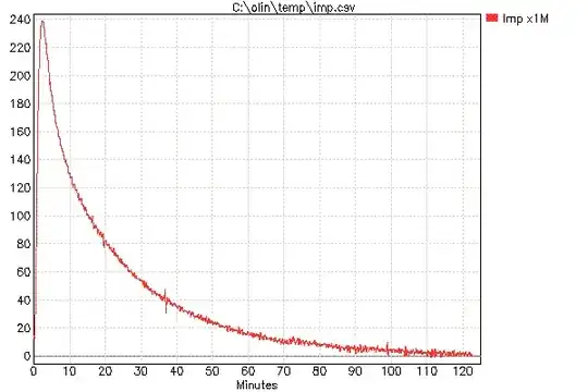

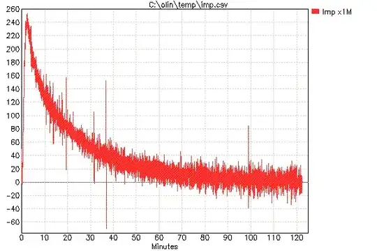

Clearly large variations between individual or even a few readings are just noise, so we can low pass filter this to get rid of the high frequencies (the random noise), which hopefully lets us see the slower underlying response. Here is one attempt:
That's better and shows there really is meaningful data to be had, but still too much noise. Here is a more useful result obtained with more low pass filtering of the raw impulse data:
Now this is something we can actually work with. The remaining noise is small compared to the overall signal, so shouldn't get in the way. The signal seems to still be there pretty much intact. One way to see this is to notice the peak of 240 is about right from a quick visual check and eyeball filtering the previous plot.
So now stop and think about what this impulse response actually means. First, note that it is displayed times 1M, so the peak is really 0.000240 of full scale. This means that in theory if the system were driven with a single full scale pulse for one of the 500 ms time slots only, this would be the resulting temperature relative to it having been left alone. The contribution from any one 500 ms period is very small, as makes sense intuitively. This is also why measuring the impulse response directly doesn't work, since 0.000240 of full scale (about 1 part in 4000) is below our noise level.
Now you can easily compute the system response for any control input signal. For each 500 ms control output sample, add in one of these impulse responses scaled by the size of that control sample. The 0 time of that impulse response contribution to the final system output signal is at the time of its control sample. Therefore the system output signal is a succession of these impulse responses offset by 500 ms from each other, each scaled to the control sample level at that time.
The system response is the convolution of the control input with this impulse response, computed every control sample, which is every 500 ms in this example. To make a control system out of this you work it backwards to determine the control input that results in the desired system output.

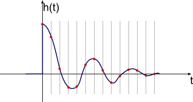

In digital filters, the impulse response is reduced to a fixed number of coefficients that multiply the signal at a certain point; the points are separated by delays, obtaining that a0 multiplies the instantaneous value of the signal, while ak multiplies the same signal after k delay units.
The figure shows the impulse response of a generic filter (low-pass in this case) where the coefficients for a 13-taps (the number of delays) FIR filter are obtained.
