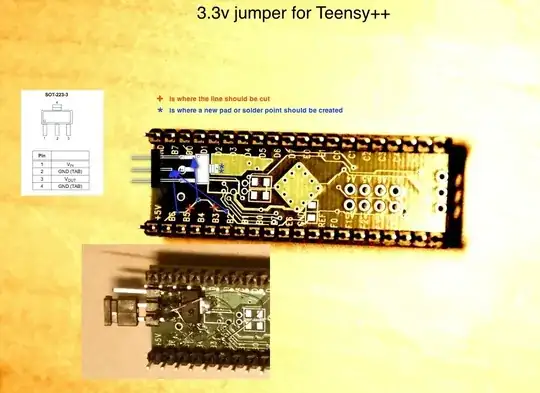

Update:
as suggested in this thread the USB part of the device will not work under 3v. I spoke with paul after ordering a couple of these. The standard Teensy has a location on the bottom to add a 3.3v regulator. On the Teensy++ (lot more i/o pins) Paul suggests I either follow the + and - lines from the USB to install a voltage regulator or I can try to splice a USB cable and add voltage regulation. To simplify matters in the future they will release a version of Teensy++ that has the spot to install a 3.3v regulator. My plan of action (for the next day or two) is to try to splice a cable. I will program the device with a normal 5v cable and then power it with a 3.3v cable for opperation. To others, my suggestion is that if you need 3.3v and do NOT need 38 i/o pins, get the standard Teensy.
Modification:
This picture shows how to manually modify the Teensy++ ver 1.0 board to install a voltage regulator and jumper so that it can be switched between 5V and 3.3v. teensypp 3.3v modifcation (full size or see flickr for embedded notes)
