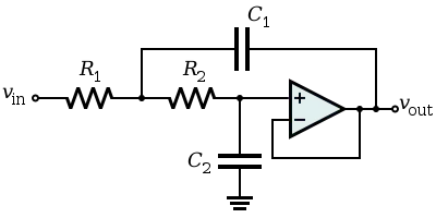

I'm trying to make my STM32 communicate VIA Can. Therefore I'm making use of the CAN transceiver MCP 2551. In many circuits I've seen a 100 nF between Ground and Vdd. What is the reason for that? Here an example:Example schematic showing a MCP2551 with 100nF capacitor between VDD and VSS
