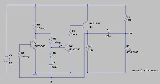

The current setup: A 9V battery powers a comparator-controlled boost converter circuit that charges a 150µF capacitor that acts as the HV power supply. The negative of the capacitor (call it ground for convenience) is connected to the filament, while the HV output (I've ramped up the voltage from 0 to around 70V) is connected to one of the segment terminals on the display. A 3V battery of two new AA cells (2.87V nominal) was connected across the cathode filament, to serve as the 'heater' supply.
I've read confusing information about the grid connections - some sources said to connect it to the HV supply, others said to bias it only slightly positive. I also tried leaving the grid unconnected. None of these configurations produced any light.
A picture is attached below of my (addmittedly rudimentary) circuit. (the 3V battery is not shown, but it was connected across the extreme left and right pins on the display)

    There's no way we can figure out what you're doing from that jumble of wiring. Show us a proper schematic diagram. – Dave Tweed Dec 18 '16 at 13:05
  • Updated to show a caricature diagram. To clarify, the only salient parts of the image are the connections to the display itself. The boost converter works as expected. – catalogue_number Dec 18 '16 at 13:16
