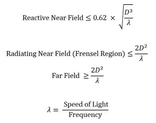

An antenna produces fields that fall into three categories: -
And, the generally accepted formulas for these are: -
So, if the largest dimension were 0.75 metres and the frequency was 100 MHz (i.e. a quarter wave monopole), the reactive near field is done at 24 cm and the far field begins at about 38 cm.
However, for a dish with diameter 7.5 metres (at 100 MHz), the reactive near field extends to about 7.4 metres and the far field begins at about 37.5 metres.
This site has a calculator and is where I took the formulas from. The formulas are generally accepted as being meaningful but, there are no hard and fast rules or limits.
This site also uses the same formulas and has a nice picture that shows how the fields gradually converge in amplitude to produce a proper EM wave at an impedance of 377 ohms (free space impedance). This is for an electrically "short" antenna: -
Wiki(Near and far field) also uses the same system for calculating the near and far fields: -
  • Thank you for the explanations and example. rfcafe is a great source that I will resort to many more times in further studies. I found that the "electrically small" means, less than 1/10 wavelength of antenna length. Now I can safely calculate the proper distances. – Xynon Dec 15 '16 at 19:50
