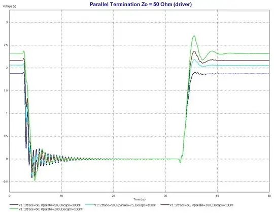

Infineon's application note EMC and System-ESD Design Guidelines for Board Layout has simulations for various parallel termination resistors, which show that you'd get more ringing:
parallel termination, driver
parallel termination, load
CL.
