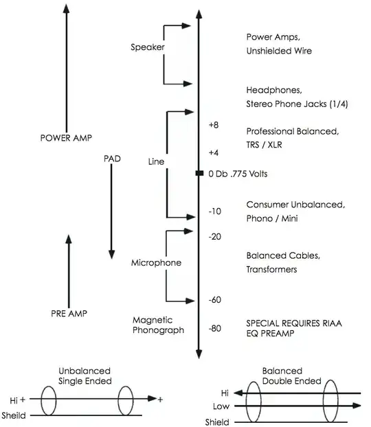

Why (microphones) preamps designs tend to limit opamp gain to max 60 dB?
A good overall picture of the whole range of what microphones and other audio devices produce: -
Picture taken from here.
As can be seen a studio microphone (depending on type) can produce a range of outputs from -60 dBm (relative to 600 ohm hence 0 dBm = 0.775 volts) to -20 dBm. This is for the standard input pressure level of 1 pascal at 1 kHz.
Line input levels are typically about 0 dBm hence a typical microphone preamp will produce have a gain range of 20 dB to 60 dB.
60 dB means 1 mV from the mic becomes 1 V out. That's about the maximum you want to amplify a microphone and feed into a "line level" input. Most microphones produce a few mV out for normal sound levels.
