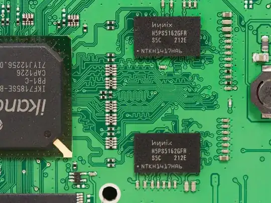

Consumer's telecom router achieve to route DDR2 and DDR3 on 4 layers board.
I've worked on several routers, not on design phase, but vast majority of this high-volume products use PCB with only 4 layers. Using 6 layers prompt a lot of discussion about cost and you should demonstrate that you really can't do a board with 4 layers.
One example of this kind of product: 2 DDR2-400 x16 chips.
Another teardown from IHS but pictures are low quality, this box also feature 2 DDR2 chips on a 4 layers PCB: http://electronics360.globalspec.com/article/3410/netgear-super-hub-2-vmdg485-wireless-router-teardown
