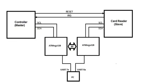

I've been trying to design a module that will allow me to modify selected slave responses on an I2C bus. Here is the original bus configuration (the pull-ups and power connections are not shown for clarity:
enter image description here There's only 2 devices on this bus and it's only 100kHz. A controller MCU (I2C master) and the RFID card reader (I2C slave) NXP PN512. I can't modify the controller firmware or change the I2C bus transactions. The good part is that the Controller sends only 2 types of transactions:
Master (Write Register) - <s><address+W><register number><data><p> Master (Read Register) - <s><address+W><register number><p><s><address+R><data><p>
What I want to do is to replace selected data bytes during the Master register read with my own bytes. I can send the register numbers the MCU wants to read to my PC over UART (921.6kbaud). I can process them in C/C++ or Python there. When I receive the register number whose value needs to be replaced I can send a fake byte back to my device and it will take care of sending it back to the controller replacing the original card response.
At first I split the I2C bus into two buses: enter image description here
I tried Arduino Nano and later a CPLD using clock stretching. ATmega328 hardware I2C facing the MCU controller could not keep up as sometimes the start sequence was generated sooner than 5us after previous stop cycle. So every now and then the AVR was NAK'ing a read transaction. The CPLD could handle the stop/start speed it turned out the bus stretching was disabled in the MCU.
I came up with an idea that I can "predict" Master register read by detecting a single byte write since I'm sure that it's followed by a read. It seems that I had enough time during the following read cycle address write to bring in the byte from the slave. That did not quite work. The bus transactions seemed fine at the beginning (approx. first 5 seconds) but then the controller was ceasing all communications on the bus as if it detected that it's not directly talking to tag read.
The card reader can also generate interrupts to the master. The IRQs are a timer or event based. I attributed the problem to the delay I was inherently introducing on the bus. I might have been wrong but I came up with another "zero-delay" design. enter image description here
The idea is that I can only break the SDA line and leave the SCL line connected between the master and the slave. This way I can still replace bytes on the data line in either direction. The design proved to be more complicated as I have to control the SDA line direction based on the bus cycle. Here is the VHDL code that handles the bus transactions and sends hex bytes over UART to the computer. Receiving bytes from the computer is not yet implemented:

Below are the bus transations captured with the CPLD controlling the SDA line.
Register write:
Register read:
You can see a few glitches when the bus direction changes. That's caused by the differences in timing between the CPLD changing the bus direction and the card reader generating an ACK. The ACK level seems to be stable on the rising edge of the SCL. As far as I know that's all you need.
With this thing in place the controller behaves the same way as with the split buses suspending any bus activity within a few seconds. I also test that w Arduino that mocks that MCU and generates bus traffic for me and it looks like Arduino also freezes every now and then. So I guess I may have some kind of issue with the VHDL state machine where under some conditions I get stuck in one state with no way out. Any ideas?

Use a microcontroller with hardware IIC slave capability. That is connected to the master. The firmware emulates the card reader. Since the only thing the master ever reads is a sequence of registers, the other part of the firmware communicates completely asynchronously with the card reader to get information from it and to control it. This also means that the reset and IRQ lines are separate too.
If done right, this has to work, as there is no cheating going on. The card reader sees a controller sending it commands and doing reads exactly how it was intended to be used. This includes responding to IRQ events.
The master thinks it's talking directly to a real card reader because you emulate all its operations just like the real thing, including the reset and IRQ behavior.
This may sound like more work than some quick and dirty jamming a different byte onto the bus hack, but as you found that's not so quick, and may always have some timing issues. With a full emulation, all timing constraints are lifted. If your emulation hasn't yet caught up to something the card reader has done, then it acts to the master like it hasn't happened yet. You basically pretend nothing new has happened until your emulation is ready to respond to the event in all aspects.
This means you really have two asynchronous parts of the firmware: The IIC emulation of the reader presented to the master, and a full card reader driver that allows you to keep all its state live in your internal memory.
Since you're not cheating, this has to work if done right. The only system-level issue is that there will be some delay in the master seeing and causing card reader actions than the existing system. This doesn't sound like a big deal for a "card reader", and considering this delay would likely be 10s of milliseconds at worst. It certainly should not be noticeable on a human time scale.
Note that the communication between your emulator and the card reader isn't limited to the 100 kbits/s currently used. You should run that as fast as the card reader and your hardware allows. After all, on that link you'll be the master, so you own the clock. Again, with proper firmware architecture and asynchronous tasks, this should not matter. In fact, your driver will probably communicate more often and get more data from the card reader than the master gets from your emulator.
Olin Lathrop
  • 310,974
  • 428
  • 915
  • Thanks for the answer. I exactly had the some in mind when I first stated looking at that. I quickly abandoned the idea as that seems to be quite complicated. If the MCU was only writing and reading the registers it'd be easy but the reader communicates with an RFID which has its own protocol (multi-byte commands and responses). On top of that the MCU is setting up a few flags for the IRQ in the reader and reading back statues. Therefore it seemed like it would be lot easier to only target a few bytes and leave the rest to the reader. – Alexxx Dec 15 '16 at 23:25
  • Also, if I split the entire bus into 2 buses I indeed can talk to the card reader at faster speeds. However with the latest design where I cut the SDA line only I have to stick to the timing provided by the MCU on the SCL line which is 100KHz. – Alexxx Dec 15 '16 at 23:33
I'd suggest you were on the right track with an Arduino Nano as the MITM, though I think it would be best with two.
The NXP-PN512 will run at 3.4 Mhz clock speed, so I'd suggest you could use something of the order of 1.5 - 2 MHz for the right hand MCU talking to the Reader.
Since the left hand MCU is set at 100 kHz, once you have recognized any transaction bytes (address/register-W-R) you can copy it over an 8bit parallel bus (or even wider) between the MCU's and send the commands to the reader in less than one clock time on the slow speed I2C channel. Equally receiving a byte from the reader is achieved in less than a clock time on the slow bus giving adequate time to setup the reply byte.
I'm assuming here that you may actually need to translate multiple bytes as an NFC ID and not just a single byte by byte conversion (which requires less time).
The major problem I'd see then is that if you do need to serialize multiple bytes to/from the PC to map your changes, timing becomes even more critical. If there was a way to build your mapping change algorithm/table into the left hand MCU that would seem a better approach, though solving a multi-bye identifier mapping is still the biggest challenge.
If I'm wrong and you just need to map say a single card identifier byte, then this might work.
In your early testing with the Arduino, did you ensure that all interrupts were turned off (at least only TWI being used)? If you did not then this may have messed with your timing.
Jack Creasey
  • 21,428
    I don't see why two separate micros are necessary. Plenty of micros can handle two IIC busses simultaneously. You really only need hardware for being the slave, although using hardware can be convenient even when being the master. Communicating between two micros seems unnecessarily complex and slow, compared to two tasks running in the same micro. I fail to see the problem that two micros solve. – Olin Lathrop Dec 22 '16 at 18:55
  • @Olin Lathrop. It simplifies software development. makes debugging much simpler etc etc. It's like why do cars have 100's of microprocessors in them rather then one (simpler as you might suggest) large multiprocess processor. I have absolutely no problem using multiple MCU's where the cost is mostly below that of single function logic chips and the functionality is easier to define and develop. In this case there is only one TWI interrupt vector in the ATMega328 so to support two channels of I2C is harder. ..But it's certainly a personal choice. – Jack Creasey Dec 22 '16 at 19:02
  • In this case, multiple processors adds complexity and introduces a need for extra communication. You don't need to use interrupts, or hardware at all, for IIC when you're the bus master. However, there are plenty of processors that can handle two IIC busses independently in hardware. If the ATMega can't, and you want to use two hardware IIC, then don't use a ATMega. – Olin Lathrop Dec 22 '16 at 19:40
  • @Olin Lathrop. Let's agree to disagree. IMO bit bashing above a hundred kHz is a non-starter. The problem for the OP is that the cost of serializing data to send to a PC to do the mapping algorithm is fraught with timing issues. – Jack Creasey Dec 22 '16 at 20:06
  • Thanks for the answer and comments. ATMega328/Arduino cannot be used on the MCU side because of the MCU I2C timing. This MCU is capable of generating a start sequence faster than 4.7us after a previous stop. Look at table 32-10 in the ATMega328 datasheets (tBUF parameter). What was happening was that Arduino was NACKing all i2c reads that followed a i2c write. It's apparently a known issue. I found info on that somewhere online after I pulled all my hair over this. This is why I switched to the CPLD. – Alexxx Dec 23 '16 at 12:14
  • I still think that I do have some issues in my VHDL code that implements the I2C switch. – Alexxx Dec 23 '16 at 12:16
