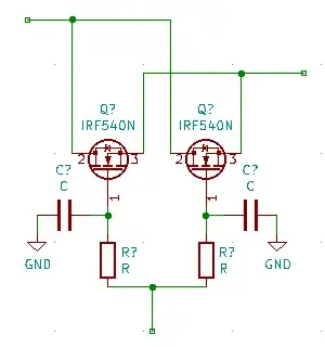

Nearly 3 years later, for the benefit of anyone finding this now... The question was answered very well, but I would also add that parasitic oscillation can be an issue if the gates are just tied together directly. Generally, you'll see a simple RC net at the gates to prevent it. Like so.
Mosfets in Parallel
The values can be pretty low; typically 470ohm Rs and 100pF Cs
