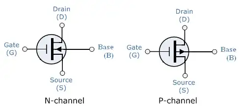

I know that , a basic MOSFET contains source and drain , and either it's a NMOS or PMOS ; it is indicated by an arrow at source . But let's look at a fabricated NMOS. enter image description here

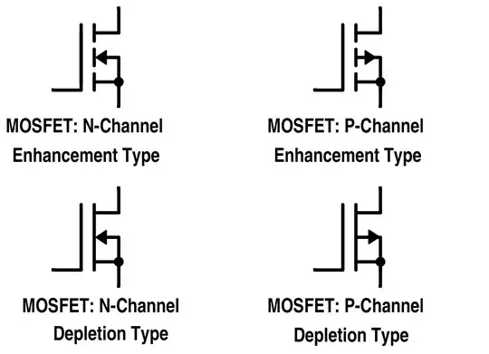

Here we can easily see that either a pin is source or drain is totally depended on the connection. Without connections , this device is symmetrical . But look at the conventional MOSFET symbols . enter image description here all these symbols marking a pin as source and other one as drain. Why is that ? Why this symbols are not symmetrical as the device is?
When I work on Cadence , schematics symbols all have this types of symbols where sources are marked .But when it will be used for fabrication , source and drain will be determined by the connection , not by the symbol.

The arrow doesn't indicate the direction of current flow, it indicates the PN junction between the body and the channel.
If you use the 4-terminal symbol, it is in fact often symmetric: enter image description here
In IC design, design kits should give you the option to use these symbols or something like them, because the body will generally be tied to the lowest or highest potential on the entire IC (maybe with even more flexibility for PMOS devices in an n-well process), not necessarily to the same terminal as the source.
In discrete design, generally you're limited to connecting the body to the same terminal as the source.

Amongst the various correct and useful information presented here so far, is the answer. But no one has stated it explicitly, and confusion lingers. This is despite, I think, a very literal and intuitive interpretation being available. To wit:
Because they're 3-terminal symbols.
Let's start with your diagram:
MOSFET diagram
As you say, it is symmetrical, except for the dashed line. The light grey lines with the voltages are guidance only - they aren't related to the structure of the MOSFET.
The corresponding symbol is the (rare) 4-terminal symbol:
4-terminal MOSFET symbol
The N-channel symbol represents the MOSFET in the diagram. In a P-channel the N and P-type regions are swapped. Be careful with the term "base" - it's directly comparable to a BJT's base in terms of N and P-types, but different enough in practice that sticking with the MOSFET terms "substrate" or body is less confusing.
A key thing to observe at this point is that the arrow indicates the PN junction between the substrate and channel. In a BJT the arrow indicates the PN junction associated with the emitter, and thinking that the arrow in a MOSFET is associated with the source is a trap.
Now, this is still a symmetrical symbol and the source/drain labels are arbitrary. What happens if we draw the dashed line from the diagram on the symbol? The substrate gets connected to one of the terminals and we no longer need a dedicated substrate terminal. The device is no longer symmetric so we can specify which terminal is the source. What would the symbol look like if we dropped the substrate terminal and joined it to the source instead?
Maybe like this:
3-terminal MOSFET symbols
Well look at that - we've ended up at your original 3-terminal symbols, no tricks, no surprises. Okay, the fact the gate terminal no longer comes out of the middle of the device is a trick - three terminal MOSFETs do indeed tend to push the asymmetry further. The gate becomes more closely associated with the source than the drain, and the \$V_{GS}\$ differential is typically of more interest, so you often see this reflected in the position of the gate terminal in the symbol.
The 3-terminal devices are far more common in day-to-day use, so the 3-terminal symbol is also far more prevalent. But it helps to see it's structurally just the (symmetric) 4-terminal symbol, with the substrate connected internally.
