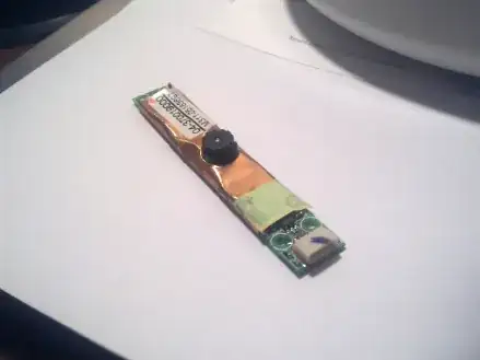

I have extracted the webcam from the laptop but cannot identify the plug type, i will post a picture later for better illustration.
I'd like to use it connected to another computer, via usb or something, but i lack the electrical knowledge to know how to go about it..
I have no datasheets nor info on how to get them..i am supposing they are tech specs from the manufacturer for the assembler of the laptop (ASUS, in my case). How do i get them?
The webcam looks like this:
Webcam view

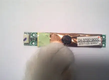

It's not clearly visible, but the connection plug has about 5-6 wires. Here's a top view with cat paw for scale (are the numbers relevant for searching tech specs?):
Top view with cat paw

    "are the numbers relevant for searching tech specs?" Apparently, yes. The first page of a DuckDuckGo search on the part number ( http://duckduckgo.com/?q=04-370019000 ) contains several hits, in a number of languages, referring to an Asus webcam. (Further research is left as an exercise for the student.) – JRobert Mar 02 '12 at 22:47

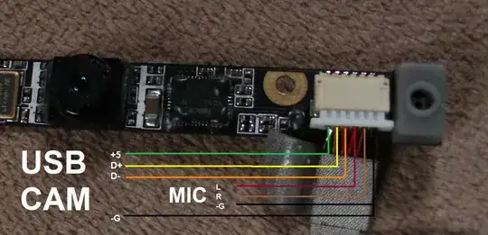

Ohh yes... I have been where you are :)
The one problem I ran into .. out of 5 broken laptops 1 uses USB interface :) the rest. well I searched and searched and searched.. most likely some propriety channels.
Looking at the number of wires does not neccesarily mean you can identify is it is USB or not. I have one with 8 wires and its USB, the others are for like switch, tilt, light sensor and most likely one for microphone i think.
The easiest way to identify if its usb is if you got the notebook running, looking in windows hardware management, and it will show under.. USB Video Device :) Or a masked name by the "driver" but still under USB.
Usually if the vendor does not have a driver, it will be plug and play USB.
The most common notebooks that i have found that use USB are, Acer, Medion, many netBooks, some fujitsus. This is just a statistical number of my own research based on notebooks i had fixed..
Some webcams might just use +3volt, Video signal(usually yellow wire) and Microphone. Some usb cameras have a seprate microphone line, others encapsulate via usb.
Now i have tens of cameras lying around.. and only 2 that work via USB... but I cannot justify running a PC on windows just to run a webcam :(

WebCam GD-6A33A; 04G620004400 (less important); 08041000101 (rather not important :) ) taken from Asus F3S (well known problem of Nvidia GeForce 8600M) works under Windows 7. Looking into the lens, wires to the right side, six wires with five terminals. Numbers of terminals from upper.
  1. “Green” wire from WebCam connected to the “black” one of USB plug (GND)
  2. “Black”, which becomes naked, unshielded silver wires (encircles two braided wires: “pink” (“orange” ?) from the 3 terminal and “red” from 4 terminal) connected to “fifth” naked wire of the USB cabel. I am not sure, that it is necessary.
  3. “Pink” (“orange” ?) connected to “green” of USB plug (D+)
4.“Red” connected to “white” of USB plug (D-)
  1. Both, “black” and “brown” wires connected to “red” of USB plug (+5V)
First I have made mistake and i had wrongly connected wires GND and +5V, it was fried a little, but still works :)
I am not sure, that it was best choice, but works the driver for Asus F9F Notebook 1.3M D- Max GD-6A31 6.10.20.005 downloaded from http://drivers.softpedia.com/get/SCANNER-Digital-CAMERA-WEBCAM/OTHER-SCANNERS/Asus-Notebook-F5R-D-Max-GD-6A31-Camera-Driver-6-1020-005.shtml as a zip folder “CMOS_Camera_D-Max_GD_6A31_vista_070315”.
Unzip. Connect the WebCam to the PC USB socket and open Device Menager (Start > Control Panel > System and Security > System > Device Menager > Unknown USB device (or You will see after You connect it). Right click, than choose Apdate Driver and choose manual option and show your unziped folder.
