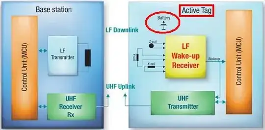

If you add a battery (power source) to a passive tag you can supply energy that could be used to power the front end receiver circuit. This means that the tag is significantly more sensitive to receiving the fields generated by the "reader". Using a battery can also mean significantly more power to be able to transmit a response to the sender.
The upshot is that the distance can be increased but, is this necessarily a good thing in some (or many) applications?
Such things as powered tags exist - they are sometimes called active tags: -
And here are the pros and cons: -
