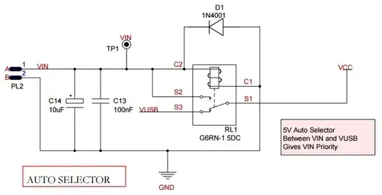

You can use possibly something like this enter image description here This is from the "Arduino Programmable Constant Current Power Resistance Dummy Load" by wigman27 on Instructables.
The relay RL1 is normally closed to allow VCC to be supplied from VUSB. If something is plugged in at VIN, the relay switches over to power the board from VIN.

  • I think that is exactly what my diagram in my Q is doing. When mains power is applied, the Common terminal (Vin to circuit) is connected to NO terminal (12V). And when mains in OFF, the Common terminal is connected to the NC terminal (Battery) – shantanu Dec 08 '16 at 09:45
  • Yes it is. I wanted to show, that your idea is possible and already used in designs. So you can go on with your own design :) – electricar Dec 08 '16 at 09:50
