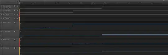

This is a view of the TX/RX logic (LGC) and voltage (ALG) of both the XBee TX/RX pins and the Adafruit 5v adapter TX/RX pins connected to the Beaglebone.
This trace is with the XBee powering on while the UART is connected:
XBee booting **WITH** UART connected
This trace is with the XBee powering on without the UART connected, and then connecting the UART:
XBee booting **WITHOUT** UART connected

  • Put a 1k resistor in series with TXD, and monitor the voltage on both sides. What do you get? – Bruce Abbott Dec 08 '16 at 12:42
  • I've put a 1K in series with TX and measured the V pre and post the 1K in another plot. No material difference at all. Pre the 1k (XBee side) the voltage sits at 0.997 and on the post side (Beaglebone) the voltage sits at 1.057. Another thing I noticed, with the XBee powered off, the RX line sits at 2.7v - when I power the XBee on, the voltage goes up to 3.3v. I'm assuming that means the XBee is drawing current from the RX line when it's powered off? – cynik Dec 08 '16 at 23:54
  • Apologies - I got confused with my wiring on my previous comment. The voltage is higher on the Xbee side of the 1k, and lower on the Beaglebone side. ![Logic probe image](http://imgur.com/a/hWSr7) – cynik Dec 09 '16 at 00:26
