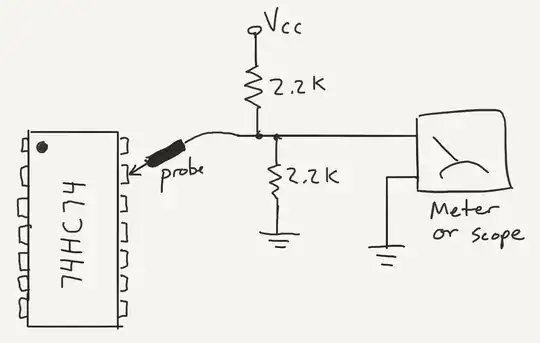

For digital circuits, this tool helps:
The benefit of this is that if you read 1/2 the supply voltage on the meter, the problem is an open-circuit on the pin. Just go through every pin on the device, and check it against the expected value from the schematic. It goes fast. This same technique works on ordinary circuit boards to find unexpected open-circuits and levels in both through-hole and SMT parts. This trick is still used in labs that have plenty of test equipment. It is good to teach a systematic approach.
