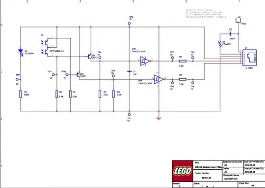

The schematics that Lego provide shows what looks to me like a perfectly normal encoder: EV3 medium motor schematic
Even if the sensors aren't well aligned or if they're slow to transition because the LED is too weak, they still shouldn't produce this output should they? My reasoning is that if it's an alignment problem then they should show the same phase overlap in both directions -- not a negative one.
I'm wondering if both lines are ramping slowly, internally, but the transition of the schmitt trigger output on one line causes some kind of noise that provokes earlier detection on the other line.
That doesn't sound right. Does anybody have any better ideas what's going on here?

The schematic shows that both phototransistors are part of the same package, so they may just be oriented in a way that they pick up the transitions in the expected order, not worrying about phase.
the phototransistors are in a single package

  • But if it's just non-ideal alignment, then shouldn't the forward and reverse directions show the same degree of overlap? I'm finding that when I reverse the overlap inverts. It's like the phase switches from 10° to 170° rather than to -10°. – sh1 Dec 06 '16 at 02:27
  • Yeah, with what I'm suggesting the signals should be in-phase most of the time. I can't think of a physical mechanism that would do this, except for something sliding around on the inside when you change direction. – Daniel Dec 06 '16 at 04:46
  • If the input with the lagging phases does not change when the direction is reversed then it suggests that there is a weakness in the electronics and that phase is not as responsive when the other phase is in a particular state, this may be due to PSU current limits or other interaction we can only guess at. – KalleMP Dec 20 '16 at 17:42
  • If the signals are otherwise valid, it is a VERY CONVENIENT way to determine which direction the encoder is going without tracking it directly... – Daniel Dec 20 '16 at 18:28
