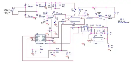

Circuit diagram:

  • The CS threshold is typically 1.04 volts (figure 19 in the DS) and your 1.2 ohm sense resistor (as per your schematic) means the peak current is 867 mA. Given also that there is a 45 ns time delay in turning off current, that's another 10 mA (ish) rise before the MOSFET deactivates. You also have an RC filter that may add a little to the timing and give a little more current so, around about 900 mA is probably what your I(limit) is and you are still significantly into the saturation region. – Andy aka Nov 30 '16 at 17:50
  • I'll also point out that your snubber might as well be removed because with a 50 kohm resistor and 50 nF capacitor, that cap will never get discharged on a cyclic nature. Think about the time constant and the effect of the diode charging that capacitor up. The cap gets charged to some value and bearly discharges before the diode drops more energy into it. This means the cap keeps charging and charging and you might easily get failure of the MOSFET. – Andy aka Nov 30 '16 at 17:55
