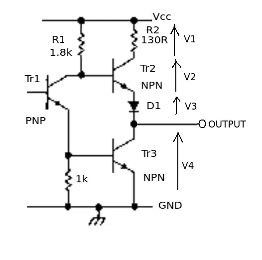

For example this is the output stage of an LM358 opamp: enter image description here

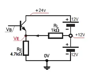

It might be easier for you to understand why output voltage is clipping at -2.1V if we redraw the circuit and change the reference point (GND) position.
As you can see I moved the GND and I hope that now the the situation is much more clearer. And now we need to ask yourself on simple question: What voltage at transistor base (VB) is needed to open transistor? To turn-ON a BJT the voltage at the base (VB) must be about 0.6 volts larger than emitter voltage.
What is the emitter voltage in this case ?
Well the Rload and RE form a voltage divider therefore
$$V_E = V_{EE} *\frac{R_E}{R_E + R_L} = 12V * \frac{4.7k\Omega}{4.7k\Omega+ 1K\Omega} = 9.894V $$
So, any voltage at the base larger than 0.6V + 9.894V will Turn-ON the transistor.
All of this means that the minimum voltage at the load resistance is equal to:
VEE - VE = 12V - 9.894V = 2.1V
Because the BJT is in Cut-off region. So, BJT is no longer able to provide any current to the load resistance.
