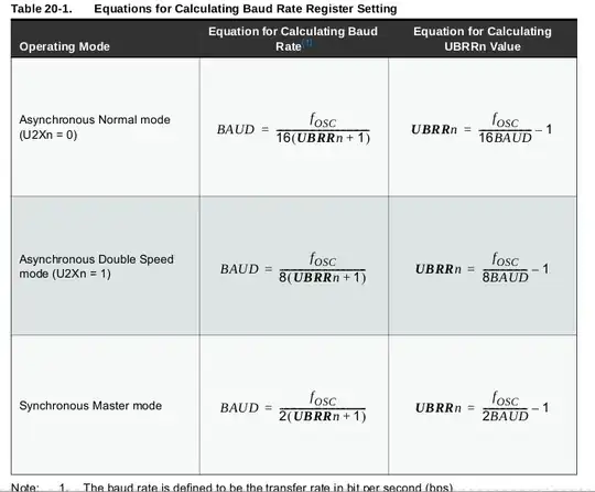

  • Do you know on what BAUD rate is set in this `uart_init` by `UBRR0H/L` registers? So what isupposed to be the BAUD rate of the Atmeg328p's UART BAUD rate? – Bence Kaulics Nov 27 '16 at 16:42
  • I dont know if this is what you were asking for? `#ifndef BAUD #define BAUD 9600 #endif` – Michael Nissen Nov 27 '16 at 16:50
