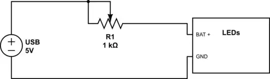

What does differ between USB and batteries is the internal resistance. The voltage on a battery will decrease appreciably when it is supplying current, whereas USB voltage is regulated and will drop very little when the current draw is within specifications. If you want to see how this could affect things, try hooking it up with a variable resistance in series. Start with maybe 1,000 ohms (similar to a very dead battery) and turn it down to 0. Observe the brightness of the LEDs, as well as the voltage across them. It will be educational, if not necessary.

  • Bad idea on the pot for 10 LEDs. Bourns https://www.mouser.com/pdfdocs/bourns_wiper_setting_apno.pdf suggests 100 mA max wiper current, and it would be easy to exceed that. – WhatRoughBeast Jan 30 '19 at 01:13
  • @WhatRoughBeast If the objective was engineering a quality piece of equipment I'd agree with you. But to hack together something on a breadboard for a quick demonstration, controlling what's already a cheaply made LED assembly, it's a non-issue. – Phil Frost Jan 30 '19 at 05:02
