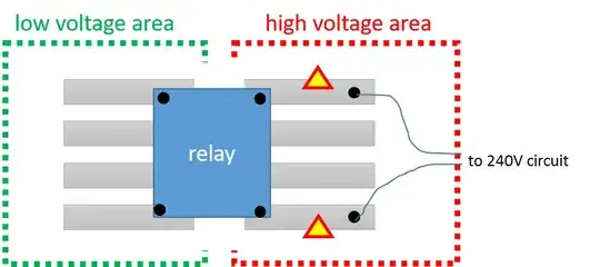

I need to use a relay to control a 240V circuit via a low voltage (5V) one:
Beside making sure that the "high voltage area" is correctly insulated from users one point which worries me is whether the strips marked with a triangle are designed to be used with mains voltage. The expected current will be about 2A.
Which current are typically stripboard designed for? I am looking for an order of magnitude (100mA vs 1A vs 10A)

    Can I assume this diagram is for illustration purposes only? Because otherwise you're going to turn on the relay and the breaker will trip (hopefully) if the mains plug is plugged in. – user253751 Nov 22 '16 at 19:51
  • @immibis: yes, I realized after having posted that the right side does not make sense. It will be a real circuit with mains and a lamp or something similar :) – WoJ Nov 22 '16 at 20:09
  • @WoJ -- even if it is for illustration purposes, would you mind substituting the image with a correct one please? It'll only cost you a couple minutes.. You never know who will see this and try to copy it, idk.. just in case. – Wesley Lee Nov 22 '16 at 21:09
