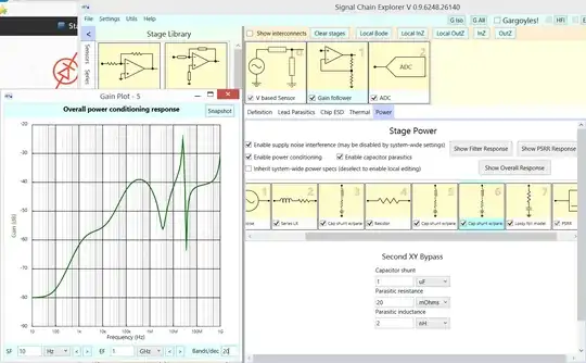

Capacitors in parallel WILL RESONATE. You need to identify those peaks (and valleys) and intentionally pick lossy dielectrics or insert dampening Rs. The first screenshot shows the valleys and peaks for 100uF and 0.01uF and 1uF. The final capacitor[20 pF] uses SkinEffect for dampening.
Use the free tool Signal Chain Explorer, in the "Gargoyles" mode. And click on ONLY the PSI {power supply interference} button. Then examine that PSI database (table of interferers) to ensure the 60Hz and 120Hz and SwitchReg and FPGA interferers are enabled. SCE is downloadable from robustcircuitdesign.com
The default topology is just a sensor and ADC. Click on Sensor, then go to left margin, select "amps" and select the amplifier stage closest matching your needs. Double click to insert. Double click again, for a 2nd gain stage. Edit the opamp specs (Unity Gain BandWidth & Rout in particular). Edit the Rg and Rf to set gain. Click "Update" on top right, and you'll see the SNR and ENOB predicted by the tool at specific FOI frequency-of-interest. Edit the "Sensor Stage" for voltage.
And edit the Power Supply Rejection params {corner freq and Max Atten}
This is what you will see, for "filtering"
