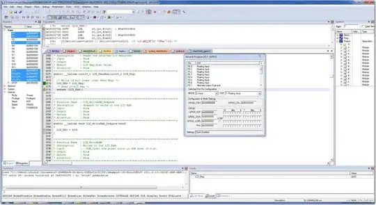

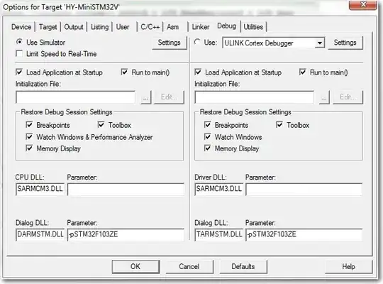

I tried to run LCD software in Keil for STM32, but I got
*** error 65: access violation at 0x60000000 : no 'write' permission
Do you know how to solve that error ? I saw that I can create a MAP, but it didn't work
MAP  0x00000000, 0x70000000  READ WRITE  // allow R/W access to IO space
Click for full resolution
(Click for full resolution image)
from this definition :
#define LCD_REG              (*((volatile unsigned short *) 0x60000000)) /* RS = 0 */
#define LCD_RAM              (*((volatile unsigned short *) 0x60020000)) /* RS = 1 */
Thanks for reading
I'm using simulator enter image description here

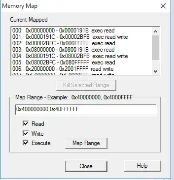

If you want to use the simulator:
  • select the simulator in project properties on the debug page
  • start a debugging session. Don't run the code yet
  • go to Debug -> Memory Map... and manually map the ranges the simulator cannot find.
For example:

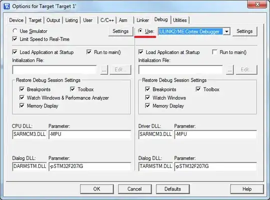

Try going to:
Project -> Options for Target '<your target>' -> Debug tab
and select the debugger option. enter image description here
