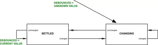

Now, on to doing this through observation with a microcontroller.
I usually use a state machine to handle debouncing. This is almost always driven by a regular "heartbeat" timer I set to about \$8\:\textrm{ms}\$, where possible. (I generally do NOT use edge-triggered interrupt events for several reasons.)
The state machine looks like this:
The value of DEBOUNCED for the switch could take on "inactive", "active", and "unknown" values. In this way, you could make sure that your software waits until the switch value settles down after initialization. But usually, I don't bother with that. I replace the "unknown" value with some default value and just use a binary value system, instead.
The state machine is entered by first setting the debounced value to its default and then entering the "CHANGING" state of the state machine. At each time interval (typically \$8\:\textrm{ms}\$ if I can get away with it), I will read the current switch value and perform an update of the current state and possibly, the debounced value. Then I just exit. The high level code then only accesses the debounced state.
If it matters to me, I may also keep a prior debounced state. In these cases, when updating the debounced state itself, I will first copy that state to a 'prior debounced state'. I can then use the pair of values to determine if there has been a debounced transition. Sometimes, I don't care about transitions. Sometimes, I do. So it depends. But in all cases, I only want to know about transitions that have been debounced. I never care about runt transitions. So high level code never uses any of the internal state that the state machine uses for its own work.
One of the nice things about this method is that I can debounce an entire port of switches, at once. And I can do it without a single branch in the interrupt code, too. This means very fast and short debouncing code for up to the port-width of the microcontroller (usually 8 bits wide.) An example from the Atmel AT90 shows how this is achieved using a Timer0 interrupt event:

Now, this example shows the full deal, including the previous and current debounced switch values. And it performs all of the necessary state transitions, as well. I don't show the initialization of this code. But the above gets the point across about how easy the state machine is to operate and how little code is required to do so. It's quite fast and simple and does not require branching (which sometimes involves additional cycles as well as additional code space.)
I prefer using \$8\:\textrm{ms}\$ timing because long, long testing with a variety of different people using equipment I've worked on in the past has led me there. I've tried longer periods and when I do so, I start to get people telling me that the "responsiveness" isn't "brisk" enough. (These days, with children growing up working real-time "shoot 'em up" gaming, I might even shorten it up further. They will complain bitterly about even slight delays caused by modern digital TVs in setting up and displaying a frame.)
Some people will have very clear feelings about how crisp and responsive a system should be. Crisp and responsive means sample more often, not less. But personally, I find \$20\:\textrm{ms}\$ observation periods acceptable. (I do not find longer times good enough even for me, though.)
Please note that the state machine I've mentioned must first enter the SETTLED state and then stay there for one more sample time before the value for DEBOUNCED is updated. So pushing a button and holding it, even in the best circumstance, will require these transistions:
  1. change from SETTLED to CHANGING
  2. change from CHANGING to SETTLED
  3. stay in SETTLED, updating DEBOUNCED
So a new debounced state requires a minimum of 3 sample time periods to achieve.
A push button will require at least 6 sample times to go from inactive, to active, and then back to inactive.
I mentioned the above details so that it is absolutely clear that a sample time of \$8\:\textrm{ms}\$ means that it somewhere between \$16\:\textrm{ms} \lt t \le 24\:\textrm{ms}\$ to go from inactive to a recognized active debounced result. And it will take another \$24\:\textrm{ms}\$ before the state can return to inactive. That's a minimum of \$40\:\textrm{ms} \lt t \le 48\:\textrm{ms}\$ to go through an entire push button cycle.
Using longer sample times will have correspondingly longer periods. Using the \$20\:\textrm{ms}\$ I mentioned as "acceptable" to me already then means somewhere around \$100\:\textrm{ms} \lt t \le 120\:\textrm{ms}\$ for an entire push button cycle. And that is getting squarely up into the area where people do tend to notice. I certainly don't like the "feel" if it gets any longer than that.
If you go this route, don't be cavalier about using longer sample times. If you must, then I think you also must do a lot of testing with users/consumers.
And if you are developing code for a typing keyboard, then use shorter times. The record for a typist was set decades ago at 217 wpm. This results in about one key every \$45\:\textrm{ms}\$. Typists like that are hitting multiple keys in a controlled ordering. To get good performance for very fast typists using a mercury-wetted reed relay switching system, I found that \$2\:\textrm{ms}\$ worked well.

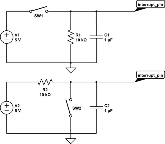

This is pretty similar to Tony Stewart's Answer, but I think it could be expanded some.
The top schematic is for either a interrupt on low or on falling edge. The bottom schematic is for an interrupt on high or a rising edge.
personally, given the cost of a capacitor, it is worth it to me to simply use it, rather than worrying if my software debounce is buggy.
Note that as Tony Stewart said, the time constant in this circuit is 10ms \$(R * C\$ or \$10k\Omega * 1 \mu F) \$. It is going to take somewhere from three to five time constants (depending on the sensitivity of your microcontroller for the button to reset itself, so if your microcontroller has issues with repeating the interrupt function, that may be the cause, and you may need to adjust the cap/resistor to make the interrupt not happen multiple times (That is, only if your interrupt is set to work on a high or low signal, and not the rising or falling edge.
Related to Hardware debouncing
    Either version works for both +ve or -ve edge, especially if the interrupt pin has a schmitt style input characteristic (many do). Both SW1 & SW2 experience a current surge when closing. Some carbon-button pushbuttons may give different results than metal-dome pushbuttons. – glen_geek Nov 17 '16 at 16:36
