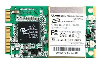

A typical PCI-e wireless LAN card whose webpage contains the search string you ask about has the picture below. And includes text
  • Host Interface supports USB 2.0 via mini PCIe format.
and
  • Works with any board equipped with mini PCIe.
"via mini PCIe" and "equipped with mini PCIe" tell you that this is NOT an alternative to USB2.
