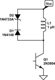

Edit: I'm also puzzled by the following diagram from the tutorial above:
Wouldn't this take any flyback voltage and dump it into the Vcc net? Would it not be a better idea to have the relay coil be between TR1 and ground, and the diode dissipating the flyback voltage to ground?

The current from the relay opening doesn't go into the Vcc rail at all. It follows the path shown here:
The stored energy is dissipated in the diode drop and the coil resistance of the relay.
In the Zener diode configuration, the stored energy is dissipated in the full Zener voltage of the diode. V*I is a lot higher power, so the current will fall faster and the relay might open a little faster:
MOVs are different than Zeners, but fulfill a similar circuit function: They absorb energy when the voltage exceeds a certain level. They are used for overvoltage protection, not for precision things like voltage regulators.

    Nice explanation of the Zener config… Makes perfect sense when it's spelled out! I still don't understand why (in a larger circuit with more components) current from the de-energizing coil wouldn't go all over the board on the Vcc net though. Isn't it seeking a better path to ground? – Kaelin Colclasure Feb 21 '12 at 00:59
    No, remember ground is just a convenient name for "zero volts". If you like to anthropomorphize current, consider the current in the inductor when the transistor opens: it wants to keep going even after the switch opens and will generate as much voltage as necessary to make that happen. The various snubbers are just providing convenient paths for that current. – markrages Feb 21 '12 at 04:14

The zener diode would normally go in series with the freewheel diode, cathode to cathode (pointing at each other). This causes the voltage to collapse faster and therefore the coil field will collapse faster and therefore the relay/solenoid will open faster. In switch mode power supplies (SMPS) this is also known as a zener snubber.
See also this question/answer: zener diode question

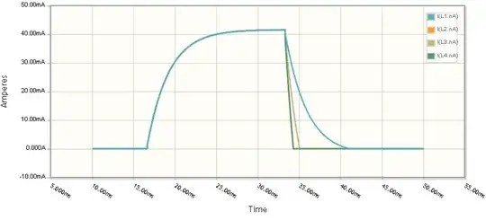

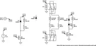

Some of these answers are confused about what happens with a simple diode. The energy is dissipated primarily in Rcoil, not in the diode.
Key is that when using a diode, the dissipation is an RL exponential decay (like RC). It is being exponential that makes it take so long (especially since release current might be only 20%). With a zener it is a linear drop to zero.
This simulates a real relay from its datasheet values of R and L.
You will notice that the ON (current rise) time is longer that the off time using a diode (L1,D1).
This is not correct as the inductance is greater (0.74H) when the relay armature is closed (better magnetic circuit) that when open (0.49H). The real On time (with 0.49H) and the off-time with a diode are almost the same.
L2,L4 currents are the same, as there is the same drop in both cases (and the same Vdrain on the fet.
ignore this
simulate this circuit
