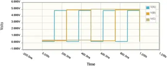

A, B and C (input signals) are potentials. They might look like this:
As you would expect an inverter (NOT gate) to do, convert a high potential into low, and vice versa, the output of our inverter, F1, is a potential representing \$F_1 = \overline{A} \$. It looks like this:
The NOR and NAND outputs, \$ F_2 = \overline{A+B+C} \$ and \$ F_3 = \overline{A \cdot B \cdot C} \$ respectively look like this:
I repeat, all these signals are voltages. We can connect multiple units together input to output, since everything is speaking the same language, comparing apples to apples.

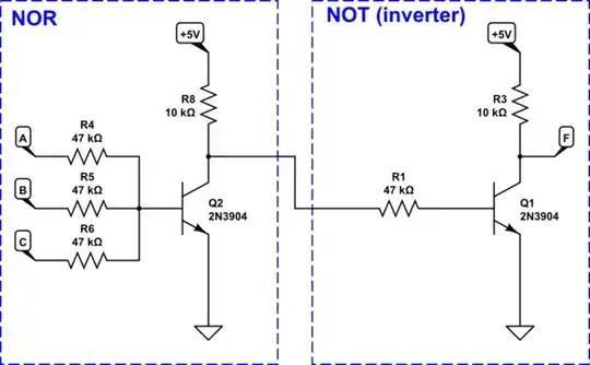

Here's how you might create an OR gate. We simply want to invert the output of a NOR gate. To do that, simply connect the output of a NOR gate to the input of an inverter (NOT gate):

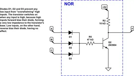

It also highlights a problem with the generalisations I have made in this answer. For example, simulate the above circuit and measure the voltage at point X. It's supposed to be a logic high, near 5V, but it's actually much lower due to the loading of R8 on the output of the NOR gate. That's another topic though. I will however show you an improved NOR gate, as a clue as to how loading issues were solved in DTL logic:
