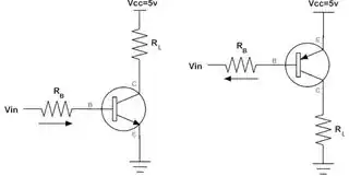

I find in reference circuits that when BJT is used as switch when it will be used in saturation mode, the load is always at the collector. For NPN the emitter is connected to the ground, for PNP the emitter is connected to power supply like this:
  1. Why is the load always at the collector and not the other way around?
  2. Since the transistor is only acting as a switch can one also use an FET instead of BJT?
  3. if one is using BJT for multiplexing multiple 7-segment displays, the current of all the 7 segments shall pass through a transistor. So, when using discrete transistor per 7-segment unit in saturation mode, will the different current gain values of the different transistors lead to difference in brightness of the 7-segment displays?

    Because that's the way you can switch the transistor on hardest, delivering virtually all Vcc to the load. And ... yes. And ... no, because you want to saturate the transistor. –  Nov 12 '16 at 19:26
    So, it is possible to use it the othe around but there will be a huge voltage drop across the transistor collector-emitter junction which is what we are preventing? – quantum231 Nov 12 '16 at 19:29

A simple reason to have the load on the collector is that it keeps the base current independent of the load. That makes it much easier to reliably keep the transistor saturated.
If the load is on the emitter, then the base current depends on the load. If the load is an LED, then the voltage you have to apply to the transistor base to reach the needed current goes up by the forward voltage of the LED.
If the load is a motor and it is connected to the emitter, then the base current depends on the motor, and will vary all over the place as the motor turns.

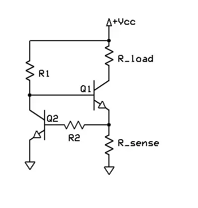

It is not necessary to use a grounded emitter, but consider the alternative
A transistor used as a switch (in saturation) will typically have a collector-emitter voltage of about 0.2 volts. Since the base-emitter voltage will be about 0.7 volts, Vs must be at least 0.5 volts above Vcc, plus whatever voltage is required across R2 to get the base current up to the level required. And that base current will be significant. Regardless of "ordinary" gain, an NPN transistor in saturation will display a much lower gain, with the typical rule of thumb being a gain of 10 to ensure low Vce. So the circuit as shown cannot be used without a second, higher power supply, which is not what you'd call convenient.
This, in turn, answers your third question. Since the transistor will be (by normal, linear standards) grossly overdriven, gain variations among transistors will typically have no obvious effect. In the circuit shown, a 50% voltage increase will cause the transistor voltage to increase from 0.2 volts to 0.3 volts, which will drop the load voltage from 4.8 to 4.7 volts, and for displays and LEDs and such this will be unnoticeable.
