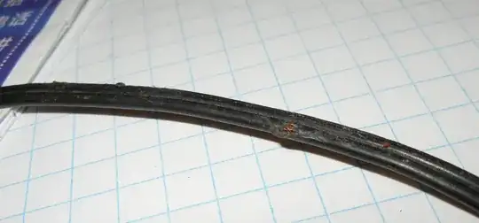

This old, crusty inductor found in an old Iskra (Yugoslavia) TV intrigued me, and I was hoping that someone could tell me what's the story behind it's design.
I don't know if the pictures are descriptive enough, but inductor's "head" is magnetic, and the plastic casing is "hugging" another ferrite cylinder with small square hole in the middle.
It's unlike any inductor I scavenged this far, and while I do understand how inductors work, I can't figure out a useful purpose of this arrangement.

  • Maybe it's a miniature line output transformer? – Andy aka Nov 09 '16 at 11:37
    Hello again! I don't think so, it only has one coil, the other existing pins are used for sturdier PCB connection. – Njubster Nov 09 '16 at 11:49
    Having a good understanding of old tv sets. I would like to know in what part of the circuit you have found it. It could be a linearisation inductor – Decapod Nov 09 '16 at 12:01
  • Unfortunately, I was a lot younger when I salvaged it, and saved it as a curiosity, so I cannot really remember :/ Someone else suggested the same thing you did, so I guess we're close! – Njubster Nov 09 '16 at 12:10
  • I would suspect that some other inductor passed through the hole. – Hot Licks Nov 10 '16 at 01:55

It's a once very common horizontal linearity adjstment for CRT raster scan TV sets.
It basically uses core saturation to achieve a somehow current dependent inductance. Bias magnet just changes current where saturation and hence "corrective" effect begins.

In old tv sets you find a vertical and horizontal deflection system realized with inductors round the neck of the tv tube. The part in the picture comes from the horizontal or line deflection system.
A line deflection system consisted of two resonant circuits where the frequency was changed by means of a tube acting as a switch. These two circuits generated each half a cosine and switched over at the top. So one half of the cosine was a low frequency (the visible part on the screen) and the other half cosine the high frequency part (the invisible flyback part). What is needed for the visual part should be linear. This is not realy the situation with a cosine. Only a very small part of the cosine can be considered linear. To make the cosine more linear a magnetized adjustable inductor was placed in the circuit thereby improving the image on the screen.

If I remember correctly (you could check it easily), the round cylinder is a magnet, and can be rotated with a screw or a similar tool. My hypothesis was that it could change the DC component of the magnetic field in the main ferrite beam, and either change the self inductance or the limit of admissible current before saturation.

As others have said it is a biased inductor used in the non linear region of the ferrites B/H curve.
http://www.repairfaq.org/sam/deflfaq.htm#dshlc has a description, basically as the current in the deflection yoke rises the inductance of this part falls as it is driven further into saturation helping to reduce the effect on scan linearity of the copper losses in the yoke.
