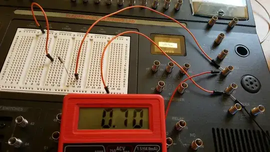

I set up a buzzer circuit in my Radioshack learning lab with a 100 kohm resistor to do some test measurements with voltage dividers (I didn't expect it to sound, I was just trying measurements.). I measured the resistance across the buzzer to be pretty high, 1700 kohms. With two components being resistors, I saw this circuit as a voltage divider with a 3V input voltage , and expected the voltage drop across the buzzer in to be 3 * (1,800,000)/(1,800,000 + 100,000) = 2.84 V.
However, when, I measured across the buzzer, I got a reading of 0.7V, 2V below what I expected. Why did the buzzer give a reading of 0.7V when I expected 2.84V? I also measured the current to be 22.8 microamps. I tried ohm's law: a voltage across a 1700 kohm buzzer with a current of 22.8 microamps would be 0.0000228*1,683,000 = 38.4V. That's way off my previous guess and measurement. Why did my ohm's law guess give a buzzer voltage that big instead of 0.7V?

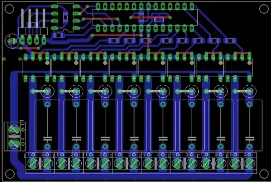

  • I opened the box up, and pried out the buzzer with a flathead screwdriver. I don't know what to think of it, I've never worked with green circuit boards before, only did the labs that came with the learning kit. Do these pictures [here](http://imgur.com/IG9miFe) and [here](http://imgur.com/WEyce65) match up with your diagram? The top part is the photoresistor of the kit, so I'm assuming the buzzer circuit is the entire bottom part. – DragonautX Nov 08 '16 at 19:45
  • @DragonautX No, the circuit board just shows two leads, I think. So the circuit I mentioned would be inside that black cylinder of the piezo buzzer shown there. Don't crack it open. Better would be to just buy another one and destroy it so you can see how they handle these inside. (I've got some here, which is where I got the circuit.) But the fact that this actually IS a piezo pretty much convinces me this is why. – jonk Nov 08 '16 at 20:12
