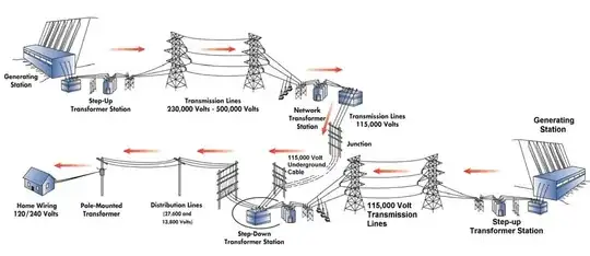

Where I live in Ontario, Canada , Hydro One owns and operates around 30,000 circuit km of high voltage lines: 115kV, 230kV & 500kV within 5% ( with <1% due to source variation and 4% from load variation) and 123,000 circuit km of low voltage <=50kV within another 5% ( which includes load variations and line drop ) and thus the subscriber enjoys a voltage tolerance of 10% max but is typically within 2% in many residential areas.
Power glitches are very infrequent as well as fault shutdowns are normally very brief annually perhaps a few times a year in one given area. This high quality service level is due to high redundancy and good condition based maintenance (CBM) rather than just time based maintenance or fault fixing. But then we still complain about rising prices and plans to privatize it short short term political financial gain and long term cost increases to users.
This is accomplished through a complex network of load-balance , rate-structures contract pricing for 27 interconnections with 2 other Provinces and 3 States in the US. The regulation of source and balance supply and demand for the best price. Since Nuclear loads must be 100% as it is not an adjustable source, guaranteed pricing and delivery.
Generation is controlled by voltage and phase to the grid and by automated tap changes for each transformer station with communication between the stations to anticipate changes.
