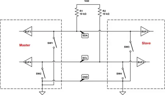

Refer to the following schematic to see the most commonly-used interface between I2C master and slave devices. This interface does not use clock-stretching. The master generates all the clock signals on SCL with SW2 (and the slave only receives these clock signals).
Data can transfer both ways - from master-to-slave with SW1, or from slave-to-master with SW3. Of course, both ends must agree on who can control the SDA data line, to avoid collisions. By "control", I mean that the switch is closed, shorting the data line to ground. An open switch allows the SDA line to rise up to supply voltage through the pull-up resistor. A closed switch has "control" of the SDA line, pulling it to ground (low). An idle bus has all switches open.
simulate this circuit – Schematic created using CircuitLab In the above schematic, the master clocks SW2 at a rate of 100k cycles-per-second (or 400k for high-speed), expecting the slave to keep up. In a clock-stretched system, the master initiates a clock cycle by closing SW2, and opens SW2 a short time later (that would normally end that clock cycle). But it monitors the clock line with BUF4 to see if R2 has actually pulled back to the idle high state. If the slave switch SW4 keeps the clock line low, that's a clock stretch, holding up further data transfers:
simulate this circuit A slave device very often has no way to perform a clock-stretch, because SW4 doesn't exist, or if it does exist, there's no way to close it. But any microcontroller has GPIO pins that can do the SW4 function - pulling low to ground. The timing of SW4 is critical: it must be pulled low only while SW2 is also pulling low, to do the slave clock-stretch function. So the pseudo-code for controlling the GPIO pin (SW4) on the slave goes like this:
Initialize GPIO pin to be an input (read). When Slave must clock-stretch, continually monitor GPIO pin, looking for "low". While SCL is low, change GPIO to be output pin, set to logic "0". Keep low until Slave is ready to continue. Once Slave is ready, change GPIO to be input, clearing the clock-stretch.

  • Thanks for the feedback. But I am using the Atmega hardware TWI module. This overrides the GPIO functionality of the pins, thus I have no direct control over them. The question was more about how to use/tell the TWI module that I want to stretch the clock. I am aware of the general principle. – Rev Nov 08 '16 at 07:00
  • @Rev1.0 You can use *any GPIO* pin as the pull-down clock stretcher - didn't intend you (and wouldn't advise you) to use the I2C clock pin as that GPIO. Use a different GPIO pin. – glen_geek Nov 08 '16 at 14:08
