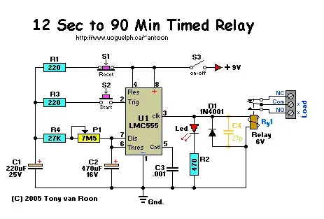

The '555' timer that Steven suggested using is a very popular IC for this sort of purpose. You'll find many such circuits on the web. Here's a more complete circuit of a timed delay also using a version of an NE555 / LM555 BUT this is a CMOS version, allowing much longer time delays. Circuit is from here but no more details given. Note the LMC555 IC.
This has start and reset buttons shown and component values.

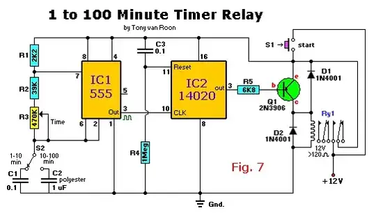

If you need a longer delay than the 555 can give you by itself you can operate it as an oscillator and follow it with a digital counter as shown below. Note that this circuit relies on having a second relay contact to terminate the timing cycle. There are ways to do this with a single contact if desired. The circuit is from here which is a useful page re driving relays with a number of other useful circuits
