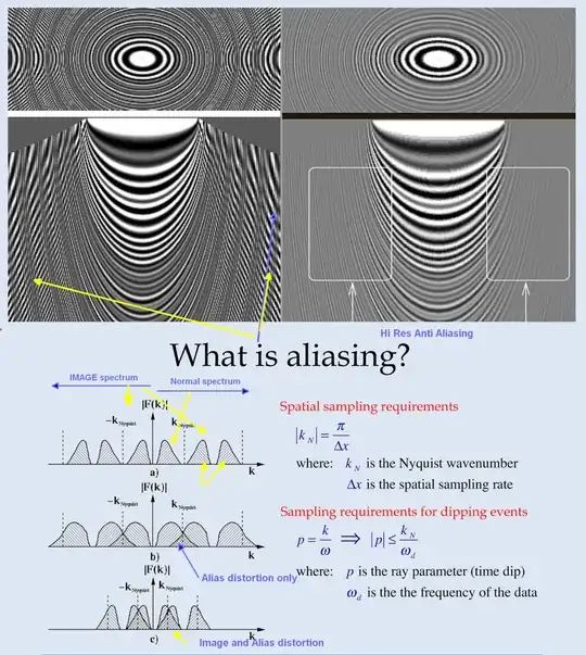

Visual aid. with my markup in Blue/Yellow enter image description here
