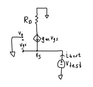

To find the Thevenin impedance we start by drawing the small signal model of the isolated network in the dotted box [Fig. 4.16(a)] (assuming \$\lambda=\gamma=0\$). Notice that we've removed all independent sources (just \$V_{in1}\$ in this case) and inserted a test voltage source \$v_{test}\$ at the load:
small signal model for calculation of Rth
From the equivalent model, we can write \$v_{gs}=-v_{test}\$ and \$g_mv_{gs}=-g_mv_{test}\$. Next, we observe that \$i_{test}=-(-g_mv_{test})\$. Thus, \$R_t=\frac{v_{test}}{i_{test}}=\frac{1}{g_m}\$. Note that this resistance does not depend on \$R_d;\$ as Sven B mentioned, if you look into the source of a transistor you'll find a conductance of approximately \$g_m\$.

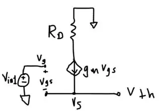

To find the thevenin voltage we've drawn the same circuit using the transistor small signal model, except we've included the independent sources (just \$V_{in1}\$) and disconnected the load:
small signal model for calculation of Vth
Because the load has been disconnected, no current can flow through the dependent current source, so \$g_mv_{gs}\$ must be equal to zero. In order for this to be true, either \$g_m\$ or \$v_{gs}\$ must be zero. Because we've assumed the transistor is operating in the saturation region, \$g_m\$ cannot be zero; thus \$v_{gs}=0\$, and \$V_{t}=V_{in1}\$. Sven B pointed out that you can also view this as a source follower, which gives a gain of 1, and \$V_{t}=V_{in1}\$.
