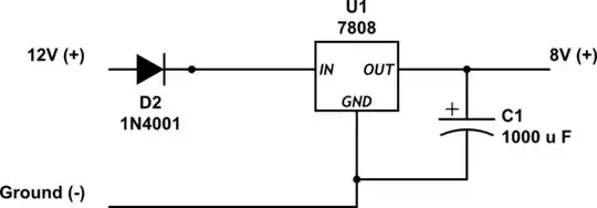

Edit 1: Circuit for the following converter(FET used is 10n60 not IRF840)(earlier IRF840 was used)-
Schemiatic of the FLyback Converter

  • I have updated the post with the schematic.( Sorry about the image). Saved it from OrCad Capture. I agree with @RohatKılıç regarding the efficiency, it should be more than 80% efficiency since it is low output circuit. Considering the 3.7k used in clamp, losses increases many times fold. Without that, zener in FET activates causing high power losses in MOSFET. – Div-lcr Nov 03 '16 at 21:43
