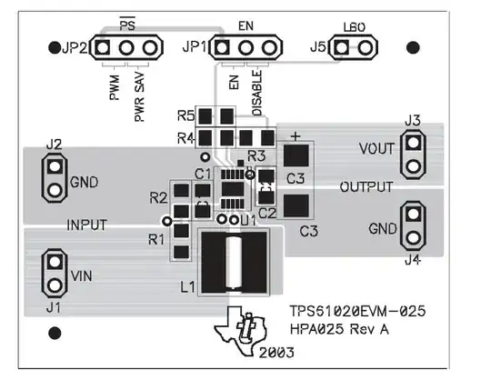

I think you should take a look at the TPS61020 evaluation board documentation:
The connection point seems to be right in the middle of the IC under the bottom pad. If you spread out your output capacitors and inductances you might get "ground bounce" if that is what you refer to by "ground loops"? Just keep the components tight together and with sufficient trace width.

  • That's what I don't understand. Isn't the entire point meant to decouple power ground and control ground? Why would the connection be made directly under the IC? It seems like any high current ground path should have its own dedicated return path to some master reference point. – Izzo Oct 30 '16 at 21:19
