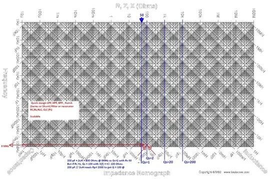

Anecdotal Experience
When I started in 1975, I usually did all my calculations on Impedance Nomograph chart unless I needed 1% accuracy. This graph works well for series or shunt filters of many kinds. Then you learn the useful range of L and C values for useful impedance ranges. e.g. Supply ripple filters to data/signal filters. But for serious RF filters they will be >5th order bandstop-bandpass with complex specs using common characteristics like Bessel, Cauer, Gaussian etc.
With reactance / impedance ratios I get Q and from Resonant frequency I get bandwidth which gives me 1st order response time.
Or from RC value I get corner frequency.
Or for Tuned filter with L and F, I can choose Q and C in either resonant or anti resonant (180 or 0 deg )
You can find this and similar charts by web searching " RLC NOMOGRAPH"
This answer was Not intended to teach you how to use it's dozens of applications, rather assumes you have a solid understanding of Q, ESR, ESL, Zo stripline and all variations of applications of RLC and just want to get a quick "Sliderule speed vs calculator answer".

FWIW some 40yrs later , I married the Mother-in- law of the son (who is also a U of T EE prof) of my Prof at Winnipeg U of M in Controls Systems 401 , who taught me how to analyze Bode Plots , overshoot, cumulative Integrated error squared analysis and Root Locus. Now when I see professional truck drivers I compare this computation in my head if I am bored driving on the highway and compare with slack consumer car drivers and imagine how robotic automated driving cars algorithms work today with PID loops and compensation for risk avoidance analysis and overshoot from excessive gain due software algorithms on high speed video and other such mind-numbing topics...
    That chart says "copyright 6/9/03." Unless you had a working time machine in 1975, you couldn't have used that chart! ;) – jonk Oct 29 '16 at 07:21
    @jonk This is my chart. There are many like it, but this one is mine. My chart is my best friend. It is my life. I must master it as I must master my life. – nitro2k01 Oct 29 '16 at 19:57
  • @nitro2k01 Okay. I was just teasing Tony, though. ;) – jonk Oct 29 '16 at 20:20
  • jonk this is just a web version that someone created with more decades , mine was on paper . I approve this message ©®™ ( you shud know betta) – Tony Stewart EE75 Oct 29 '16 at 20:24
